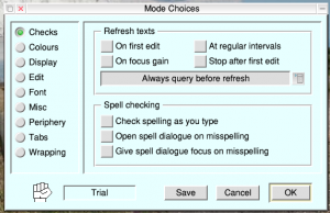

The default mode is BaseMode. The other modes simply augment, or override, it. Many features of a mode can be set in the Mode Choices dialog box.
Other features have to be specified in the mode's ModeFile and must be written in StrongED's own command language. BaseMode's ModeFile will be displayed if you click Ctrl-Adjust on StrongED's iconbar icon.
